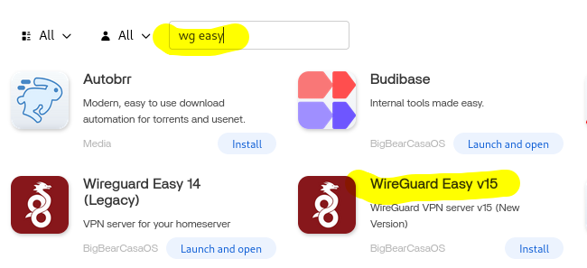

I have casaOS, not ZimaOS, but it is nearly same. When You type WG EASY in App Store, You found WG EASY 15 icon.

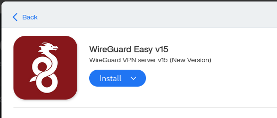

Do not click on install button, just click on Title of App.
Mouse hover over blue button “Install” and do not click:

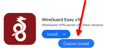

Custom install button appeared:
Click on Custom Install.

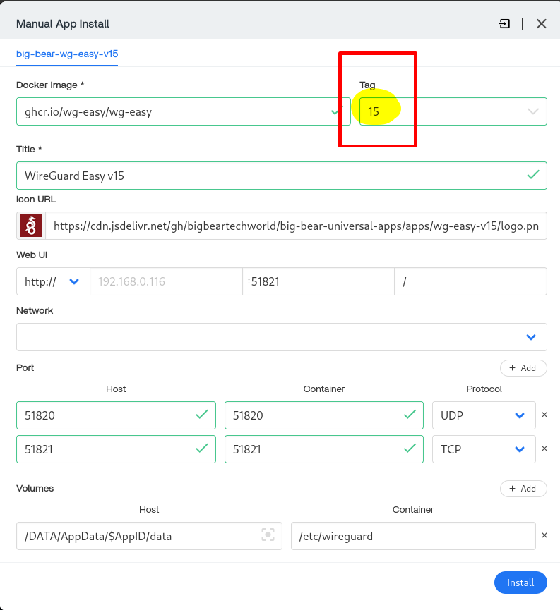

Just overwrite Tag 15 to 15.1 and hit blue button Install at the bottom of the dialog.
That’s it. You will download (and test) version 15.1
