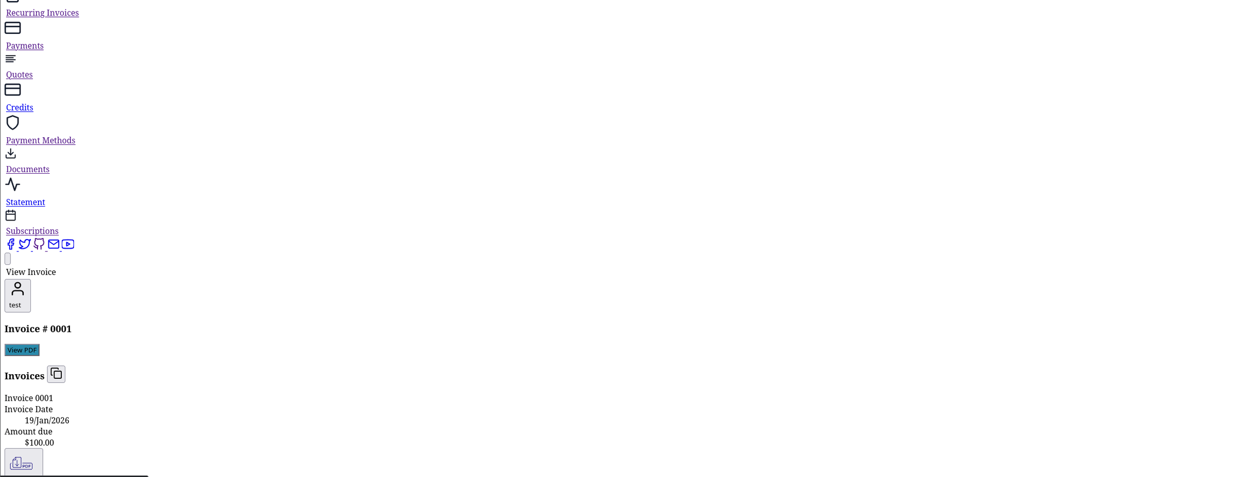

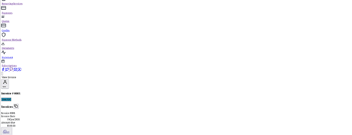

Has anyone been able to get it setup via Cloudflare tunnels?
Most of it works under the tunnel but I’ve noticed if I try and visit client portal thats where it bugs, If I connect via local ip it works fine
Edit:
After some ChatGPT’ing I was able to fix by adding environment variable TRUSTED_PROXIES = *
