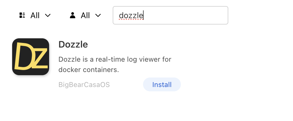

Edit: I can’t find Dozzle in your store, I see existing on GitHub page but on casaos won’t be shown
It’s in there. You will need to have BigBearCasaOS installed.
https://github.com/bigbeartechworld/big-bear-casaos/archive/refs/heads/master.zip
