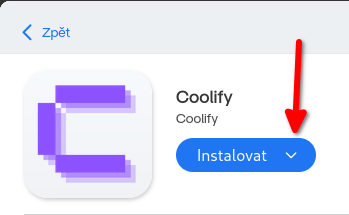

When You choose custom install (mouse hover arrow):
Change:
Ports:
Host / container
8000 / 80->8080
(from 80 to 8080)
Status will be still unhealty (health check still failed, want to connect to localhost:80), but web UI can be opened.
