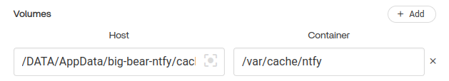

During this restart of container, all settings will be lost, it remains only settings leaved in box Volumes (mapping Host : Container)
So, if Your HA was already installed, explore this data folder on Your casaOS Host.
You can use ssh/sftp connection via Terminal. Or use casaOS Apps: Files (installed & configured with casaOS), Filebrowser (need to install).
If there is Your data leaved safe from previous installation. It is just configuration error.

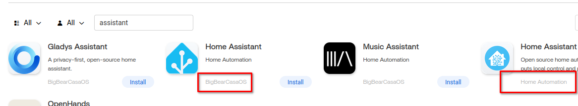

Do not be confused, there are two apps in casaOS’s App Store with name Home Assistant. Both has different version. Maybe previous You installed new one and next time try to installed second one.
