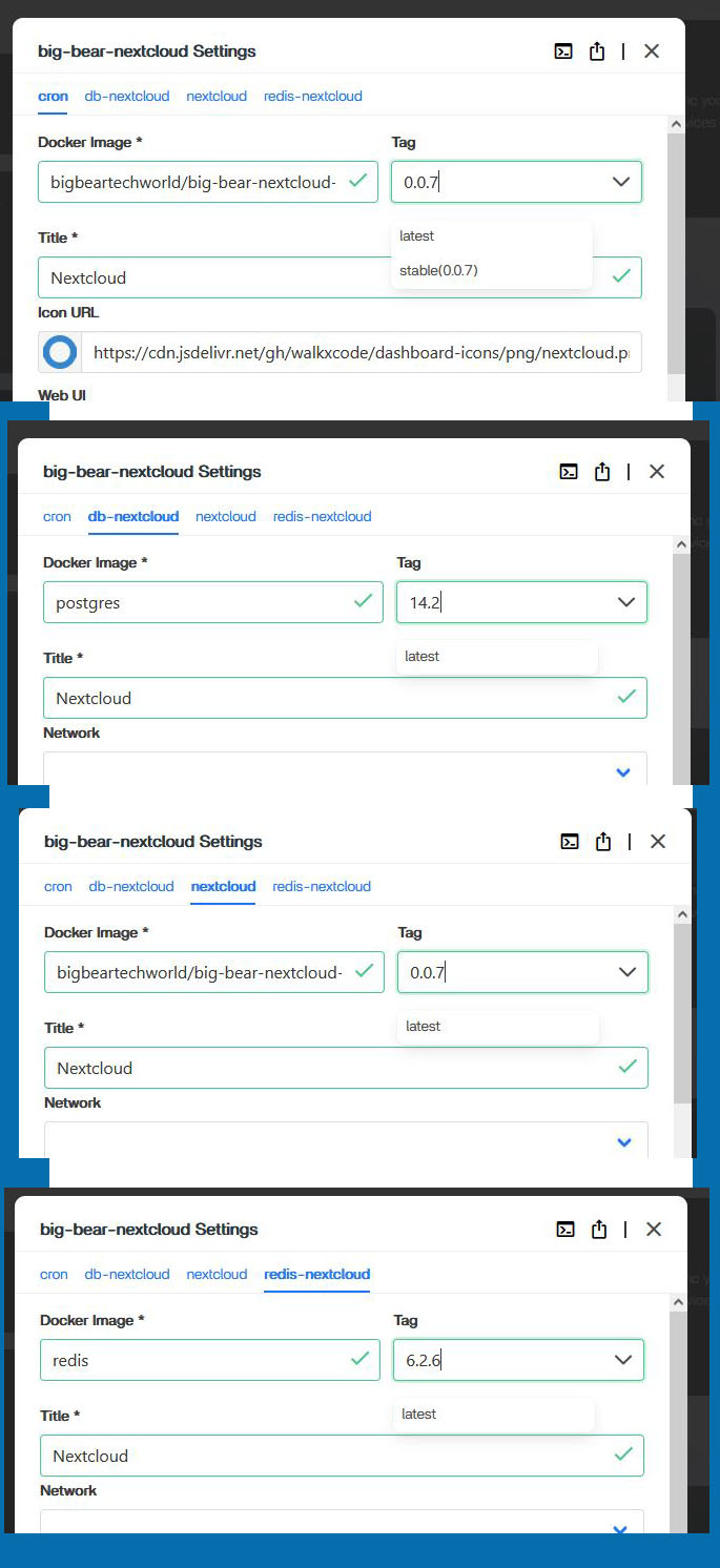

Hi…thanks for replying. Nextcloud says version 31.06 is available. However when I click each of the 4 Headers within the Settings as you suggested, I don’t see “31.0.6” as an option in the TAG dropdown. See attached
On the 3rd header, manually enter “version-31.0.6” (without the quotes) in the Tag box and click Save. You might need to copy/paste to enter it.

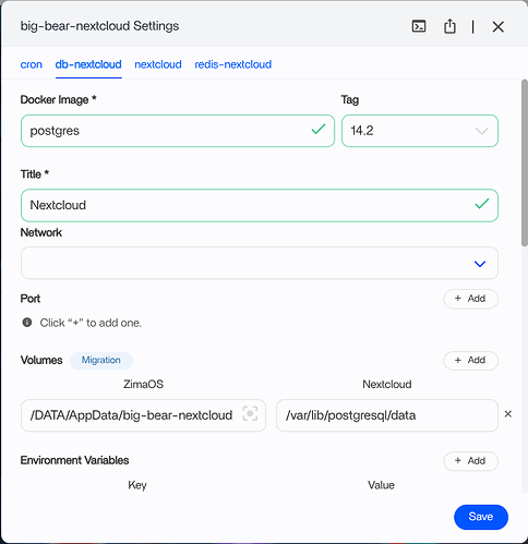

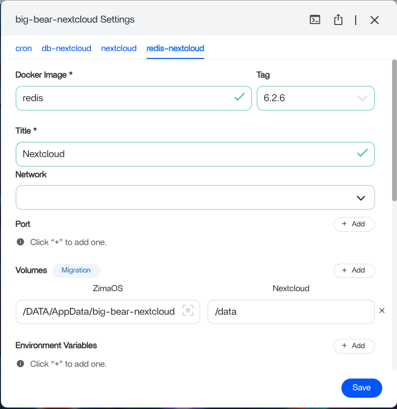

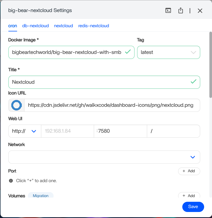

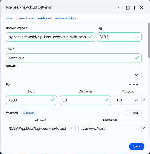

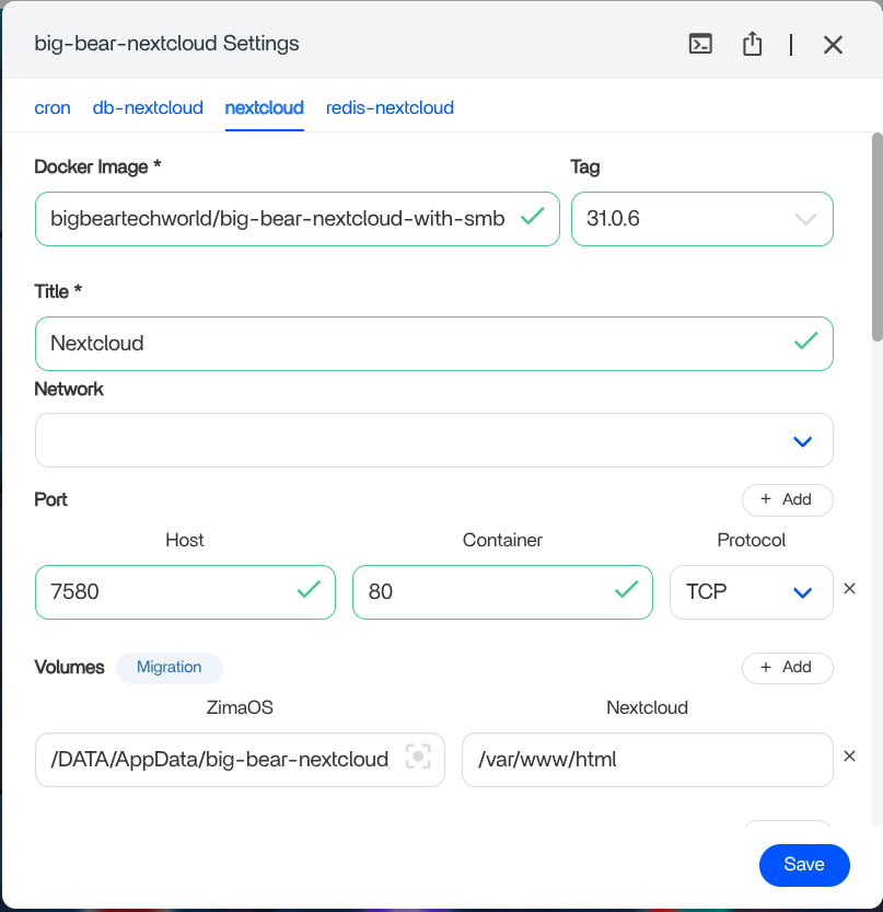

Change the “cron” Tag back to “latest”. The db-nextcloud should be 14.2 and the redis-nextcloud should be 6.2.6, leaving the nextcloud tag as 31.0.6 as shown below.
I set all 4 tabs back as adised. The redis container said unhealthy so I changed it to Latest and finally nextcloud could open again. cron=latest, db-nextcloud=14.2, nextcloud=31.0.6, redis-nextcloud=latest
