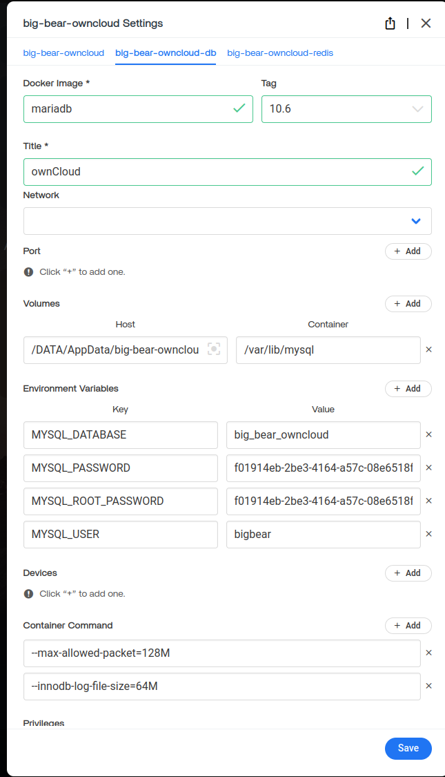

I have installed Owncloud on casaos from big bear and I cannot get it to work.
I have followed the instructions to input IP address of cassos
When I press the own cloud icon it says app not available and casaos tells me the container is unhealthy.
The big-bear-owncloud container keeps trying to start but then shuts down.
The big-bear-owncloud-db container is persistent but with the errors’ below.
I have installed on a mac mini 2012 running ubuntu server latest and casaos.

Error while trying to create admin user: An exception occurred while executing ‘CREATE TABLE
oc_appconfig(appidVARCHAR(32) DEFAULT ‘’ NOT NULL,configkeyVARCHAR(64) DEFAULT ‘’ NOT NULL,configvalueLONGTEXT DEFAULT NULL, INDEX appconfig_config_key_index (configkey), INDEX appconfig_appid_key (appid), PRIMARY KEY(appid,configkey)) DEFAULT CHARACTER SET utf8mb4 COLLATEutf8mb4_binENGINE = InnoDB’: -
SQLSTATE[HY000]: General error: 1005 Can’t create table
big_bear_owncloud.oc_appconfig(errno: 13 “Permission denied”)
