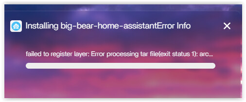

I am running CasaOS 0.4.15 on a ZimaBoard.
I currently have HomeAssistant 2026.2.2. When I try to update to stable (2026.4.1) the install fails.
I found the problem. I had to add NET_ADMIN and NET_RAW capabilities to the container. What I still do not understand is why this was suddenly required.
