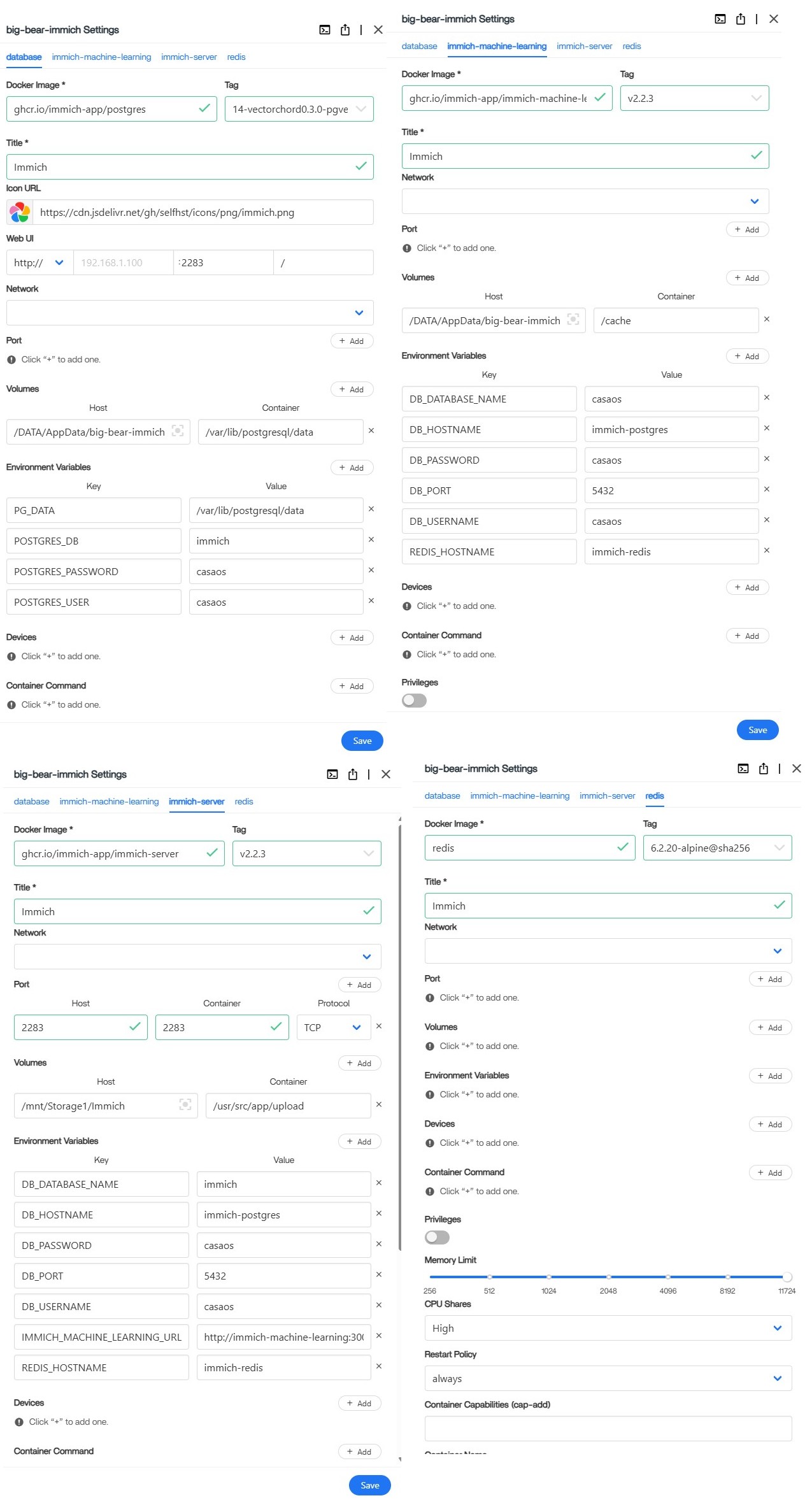

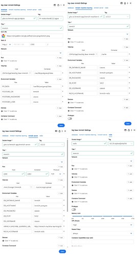

I have installed a clean version of immich from BigBearCasaOS, please tell me what is the correct code to specify to restore the immich database my path for the DB file is: /mnt/Storage1/Immich/immich-db-backup-20251120T182118-v2.2.2-pg14.19.sql.gz all other parameters are standard for installing Immich from BigBearCasaOS

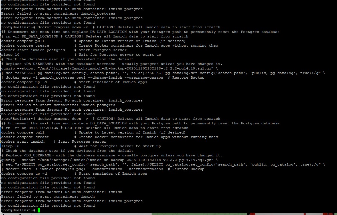

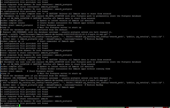

but unfortunately, I can’t restore my database in any way, I keep getting an error when running the command although I substituted the correct username and tried to select other parameters.
what am I doing wrong and what command should I enter to restore the backup?

No configuration file provided: not found
is msg related that in Your current folder, docker itself cannot find docker-compose.yml
So, when You call docker up, docker do not know what are You trying to do.

A) go to folder, where stay docker-compose.yml: cd /var/lib/casaos/apps/big-bear-immich
and call docker compose up command here.
OR
B) specify path, where you yml file stay:
docker-compose -f /var/lib/casaos/apps/big-bear-immich/docker-compose.yml …
So I guess whole is:
gunzip --stdout “/mnt/Storage1/Immich/immich-db-backup-20251120T182118-v2.2.2-pg14.19.sql.gz“
| sed “s/SELECT pg_catalog.set_config(‘search_path’, ‘’, false);/SELECT pg_catalog.set_config(‘search_path’, ‘public, pg_catalog’, true);/g”
| docker exec -i big-bear-immich psql --dbname=immich --username=casaos
docker compose up -d -f /var/lib/casaos/apps/big-bear-immich/docker-compose.yml
See different -i immich-postgress is docker container name in docs of immich. ZimaOS/CasaOS use different name. You can simply explore name of containers on Host this way:
sudo docker ps
Last column is NAMES, which is name of containers.

App’s data are stored in: /DATA/AppData/big-bear-immich
But docker-compose.yml file is located here:

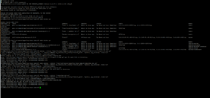

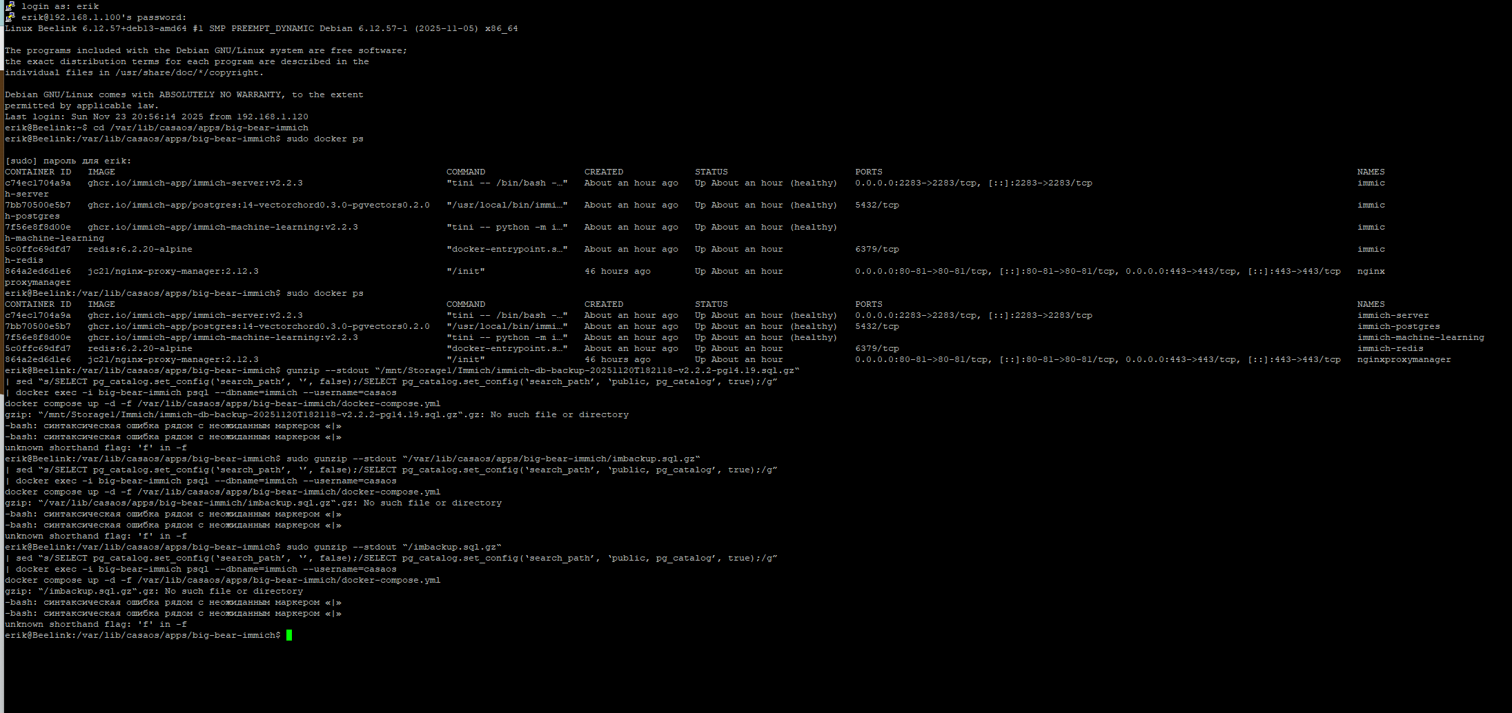

Thanks for the help, but unfortunately it didn’t work out for me ( Every time I had problems, I tried to change variables, changed the path to the file (of course, I moved the file there too) but I kept getting errors like this:
The backup file is currently here: /var/lib/casaos/apps/big-bear-immich/imbackup.sql.gz
I have a completely clean CasaOS system and a fresh installation Immich by BigBearCasaOS.
All screenshots of the settings can be found in my previous message in this thread.
I am desperate for help - can you please tell me what command I need to enter in the terminal to restore my database? I have been struggling for days and I am hoping for your assistance.

My advice was with docker exec -i big-bear-immich psql
but, when You type output of sudo docker ps
I can see (last column NAMES) Your container has name immich- postgres
So my advice here was wrong. I check it in public github repo, and yes, immich-postgres is OK name. Sorry for this my mistake here!

I am not familiar with Your national character set. If You use " or “. It is very important for running command captured CTRL+C from Internet webpage.
Your first black screenshot display: "
But Your second black screenshot display: “
Same for apostrophe! Use correct for Your setup.

-f argument in docker compose can be use before main sub-command “up”, “down”, etc.
So once again I am sorry for my mistake here.
Good must be:
sudo docker compose -f path/docker-compose.yml up -d

Your command:
sudo gunzip --stdout "/imbackup.sql.gz"
is Your typo. You stay in correct folder path and want to use imbackup.sql.gz, so must use: ./imbackup.sql.gz So typo is missed char . (dot)
Small advice: every time when You get msg about unknown path, just try same path as list:
ls path
It can easy discover typo.
I hope it is end of this unfortunate bugs. Good luck!
