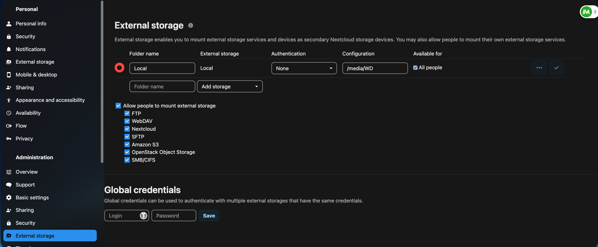

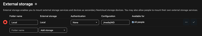

I am running into some issues when I am trying to add my HDDs to Nextcloud.
My drive is mounted to “/media/WD”, but I am unable to add this to my Nextcloud.
The “WD” drive is discoverable, and I have set full access for everyone, so it should be seen by Nextcloud too. Maybe I need to add the drive to docker settings too?

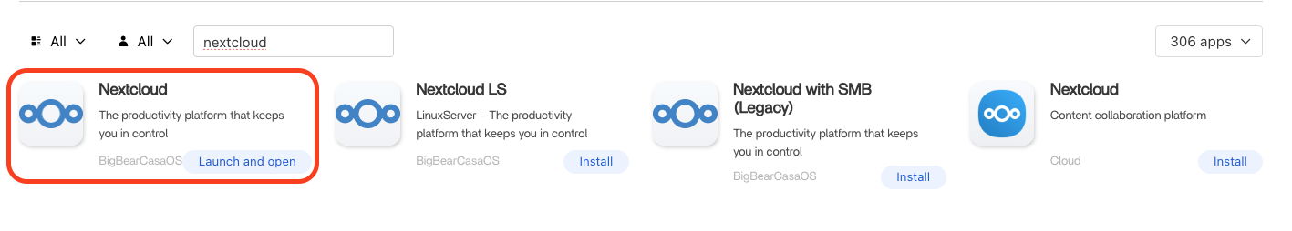

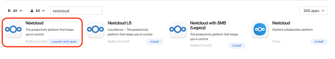

This is the Nextcloud I have:
Any advice or idea is highly appreciate!

You need to create a bind mount that connects your external drive (on the host system) to a path inside the Nextcloud container. Here’s how to do it properly:
First, make sure your external drive has the correct permissions:
sudo chown -R www-data:www-data /media/WD
sudo chmod 750 /media/WD

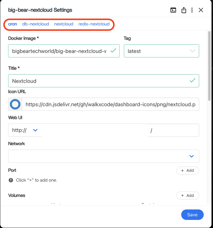

Then modify your Docker configuration to include the bind mount:
In the CasaOS App Settings for Nextcloud, add a new volume:
/media/WD:/data/WD # or another appropriate path inside the container
For BigBearCasaOS users, you could alternatively mount directly to:
/media/WD:/var/www/html/data/WD # mounts to the Nextcloud data directory

Consider using the External Storage app in Nextcloud as an alternative approach

Thanks for your reply!
Could you please tell in which tab should I add the volume? As I have 4 tabs
A few other things I might have missed adding:
I am running CasaOS on Debian
I do have the External Storage app installed
Both HDDs I have are EXT4 format
Both HDDs are mounted automatically when booting up
Also missed to say that the drive is mounted to “/media/user/WD”
