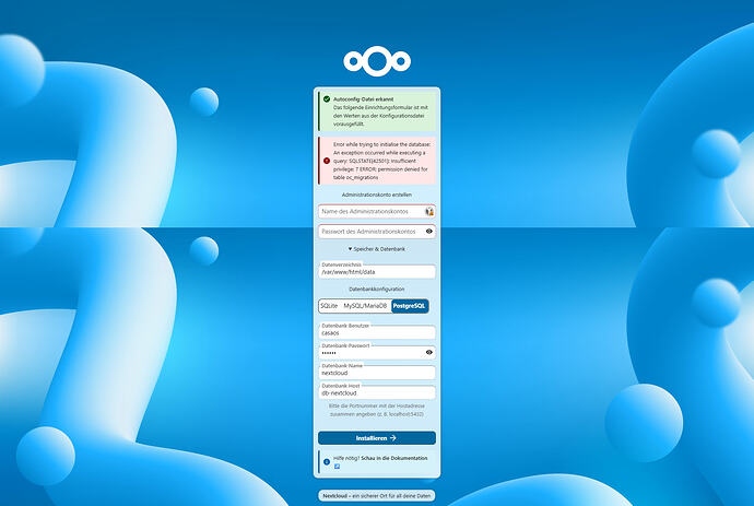

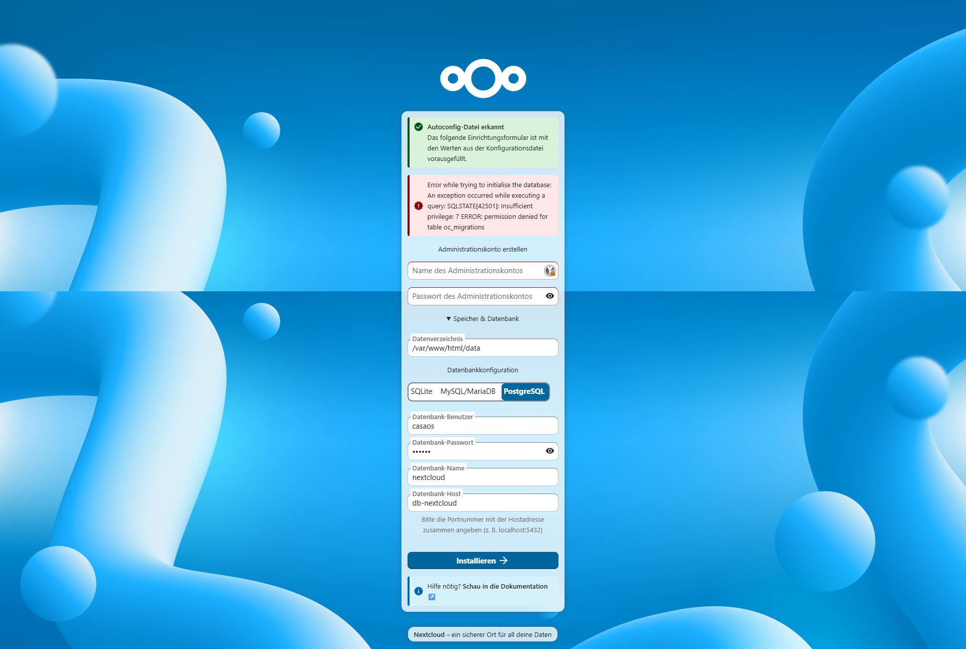

Hello, I tried to install Nextcloud on CasaOS but when I try to login for the first time, I get this error:
Error while trying to initialise the database: An exception occurred while executing a query: SQLSTATE[42501]: Insufficient privilege: 7 ERROR: permission denied for table oc_migrations
I also uploaded a screenshot of the error but it is in German.
How can I fix this?

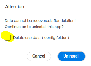

Try to uninstall it and install again.
When You have dialog Uninstall, check delete all data.
