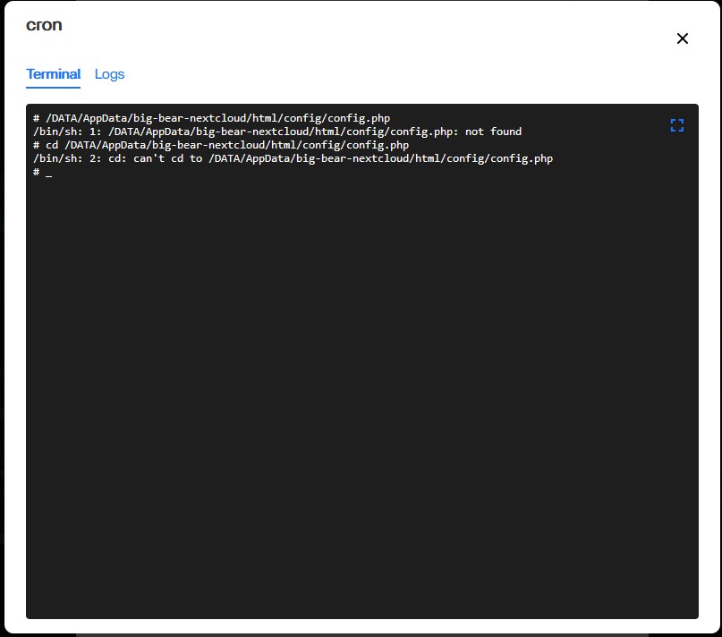

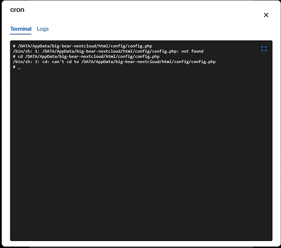

I need help accessing Nextcloud config file, within CasaOS. I need to add my local IP as a trusted domain in the config.
I launched the terminal from within the Nextcloud app, pasted the location command from the tutorial and this is the error message I get (see atttached). I also could not change the directory to the root either
Hello, here are the instructions for adding a trusted domain:
