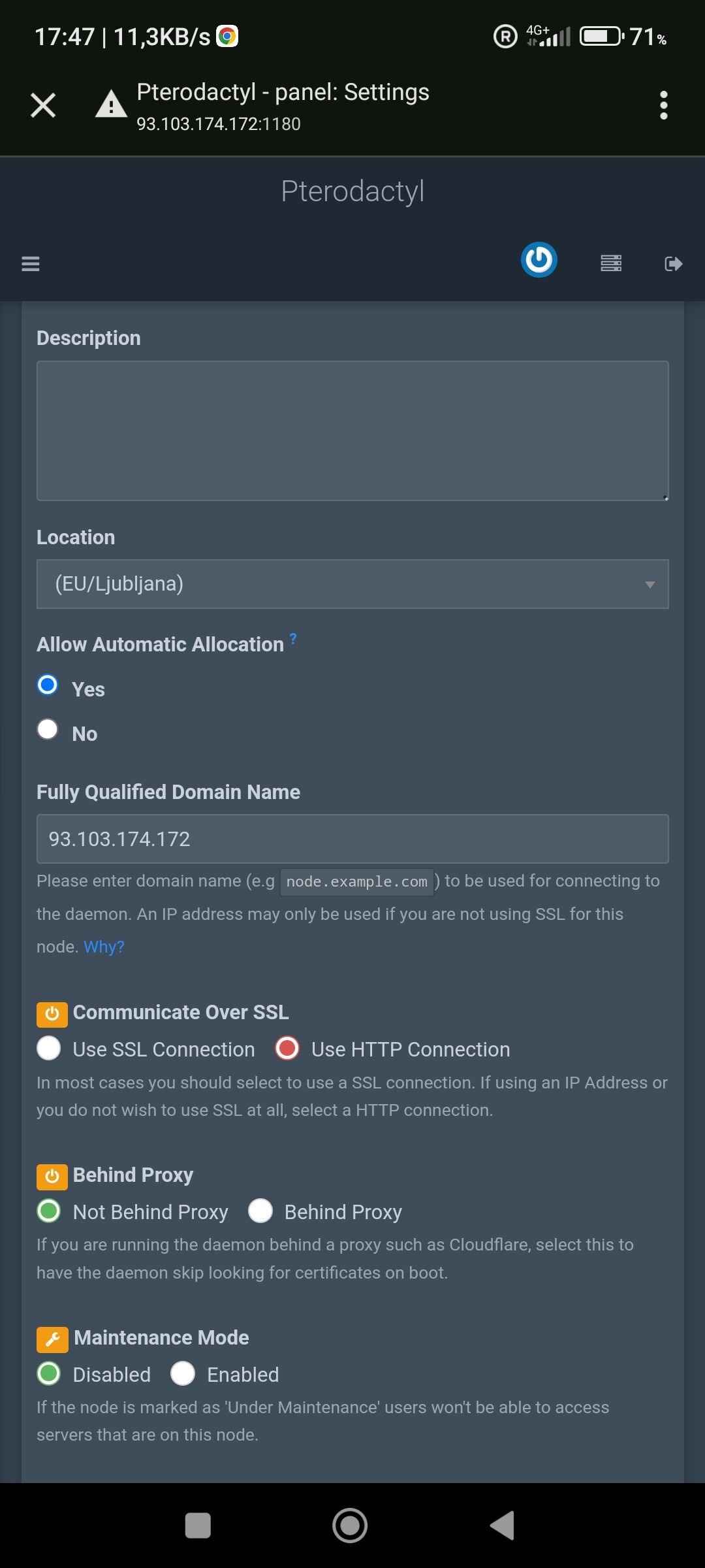

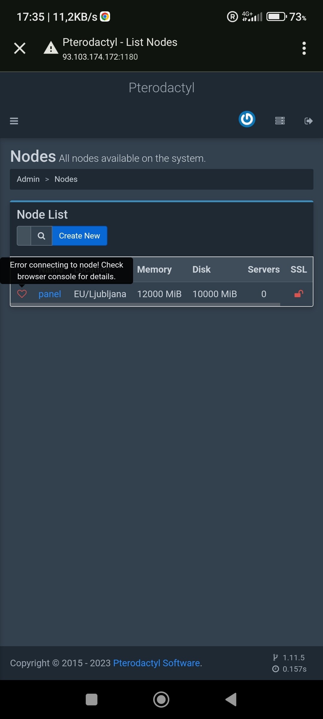

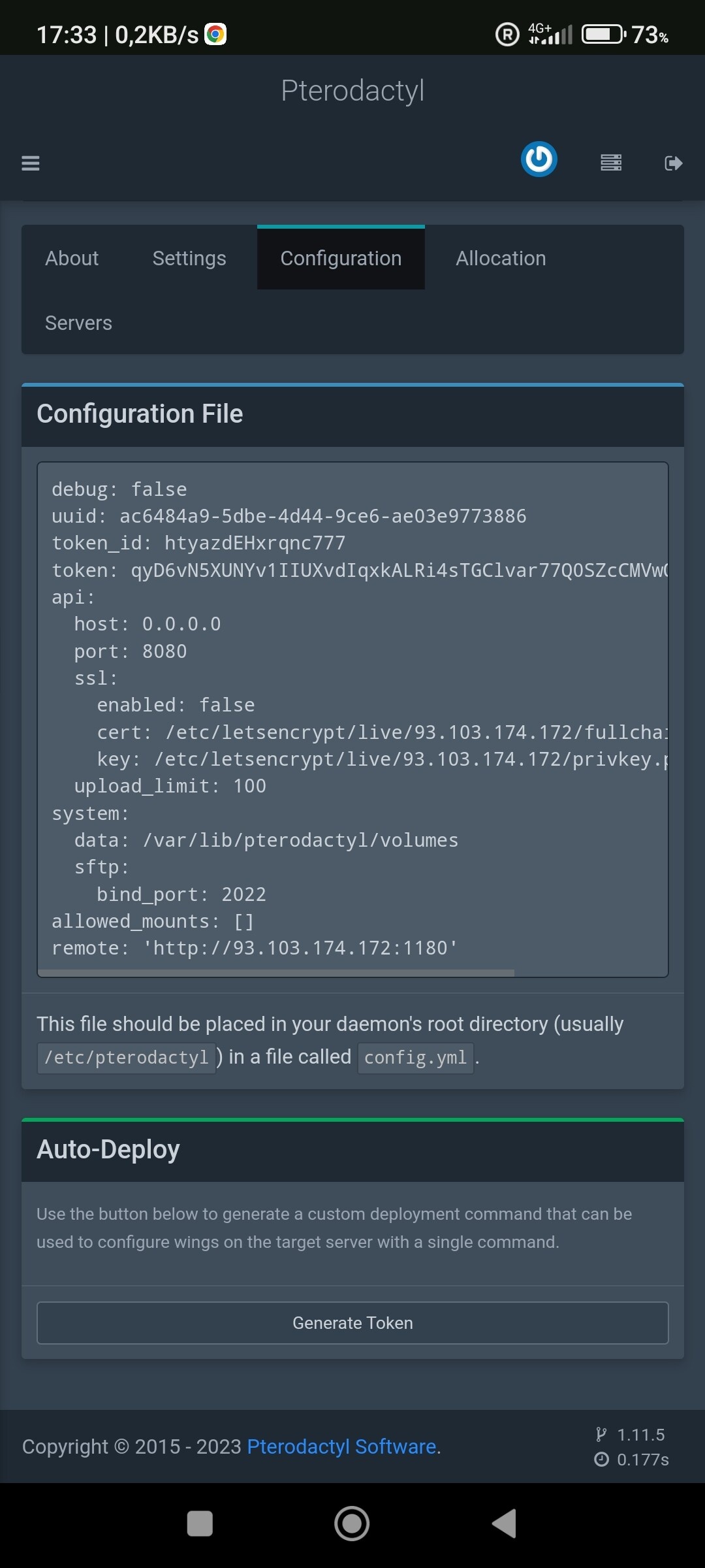

I have made it run PANEL, but Wings doesnt run. I made the node, but node always says, cant connect to node, check browser console.
Im running it on homebase server, without domain.

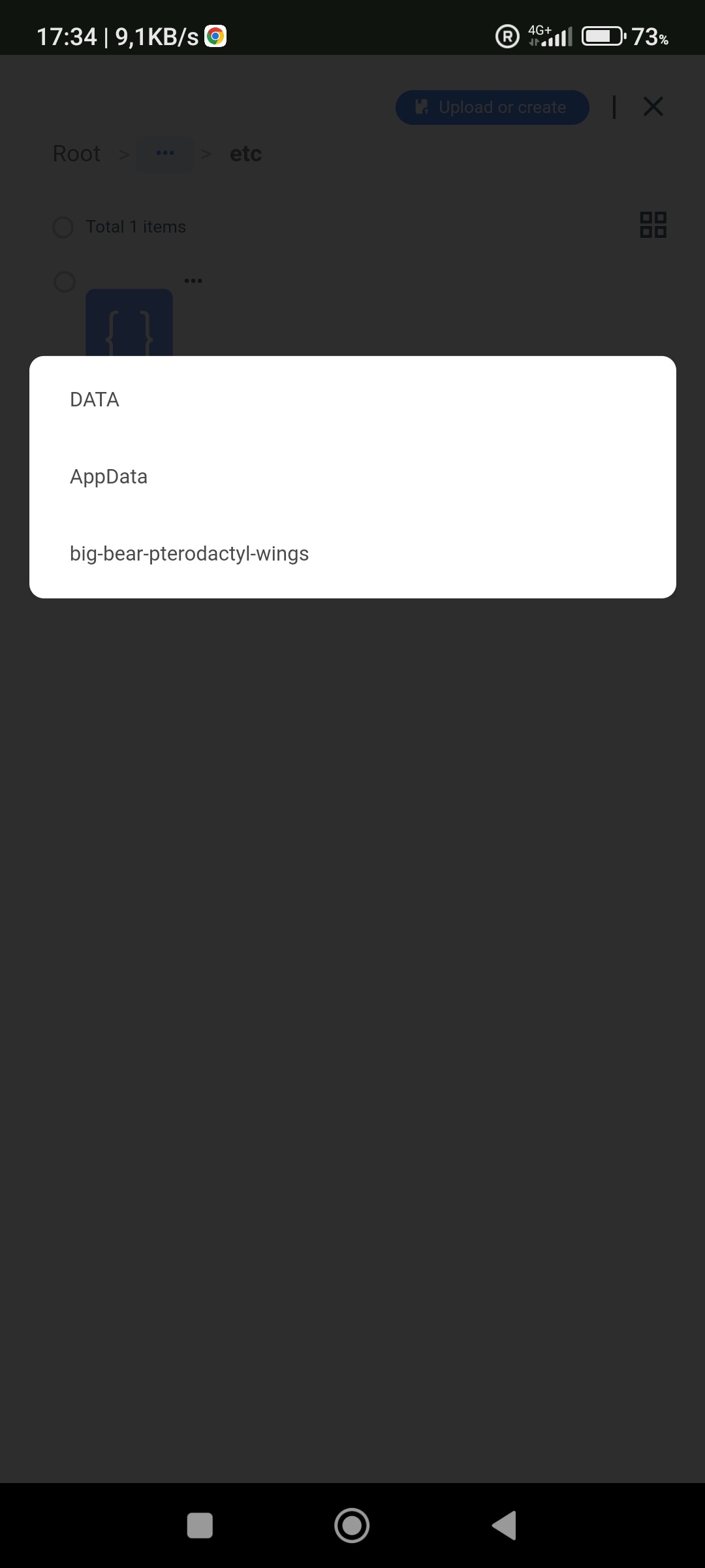

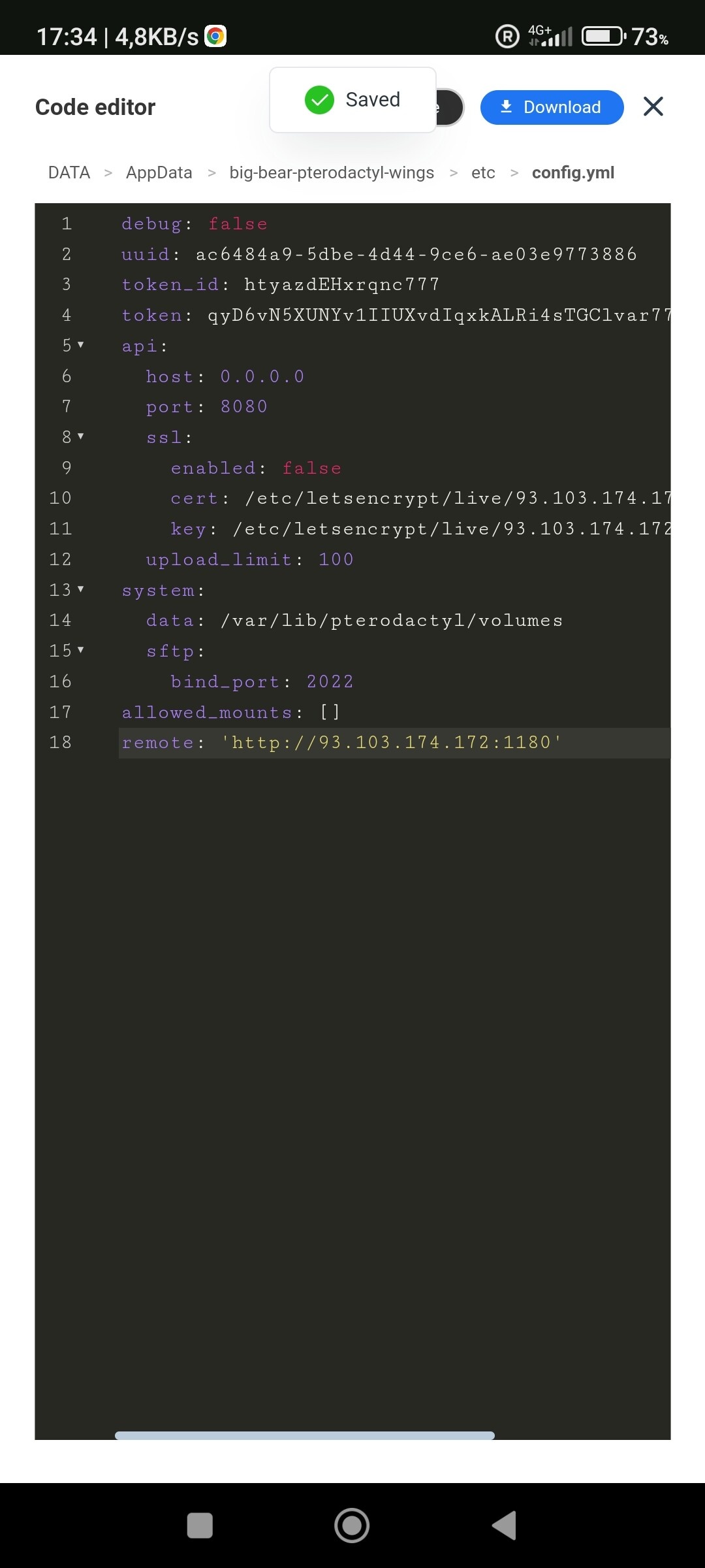

Really don’t know what is the problem. But WINGS doesnt stay running. So the node cant connect to it. I did put config.yml in AppData/Bigbeartech-pterodactyl-wings/etc/
But cant connect. I was testing today for almost 4h :joy:

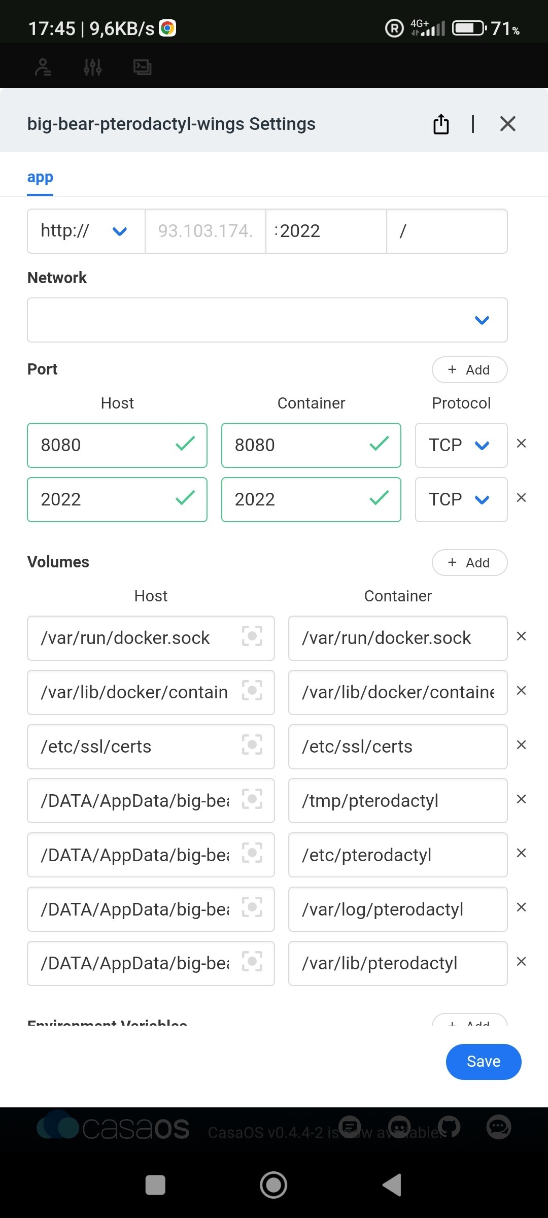

Can you show the wings container settings in the CasaOS UI?
Ports on wings should be:
Must be in BRIDGE mode or HOST? Or nothing :joy:
Is this right?
Can you try to restart the wings?

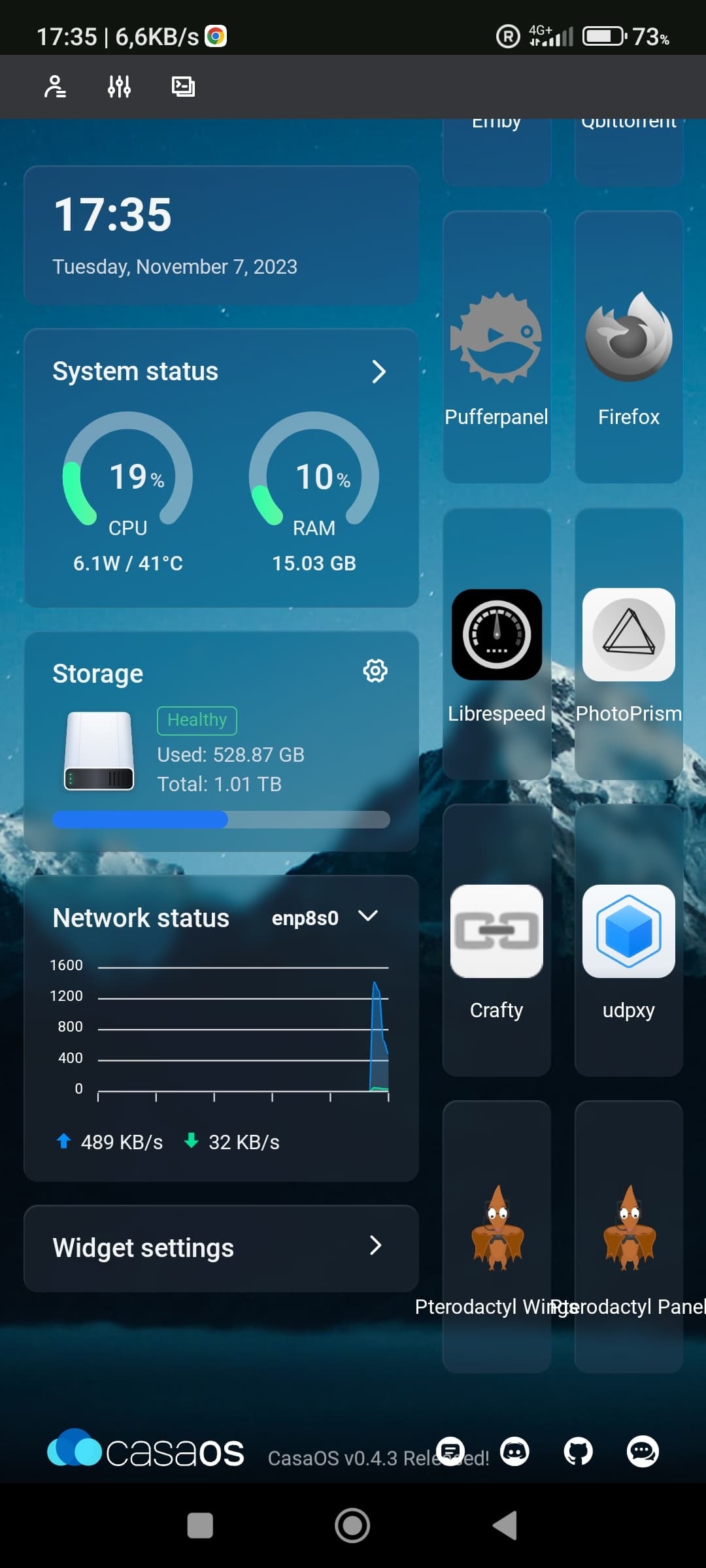

Yes, first 2second is color, then back to gray.
I found that if i disable panel, then wings stay running and is color.

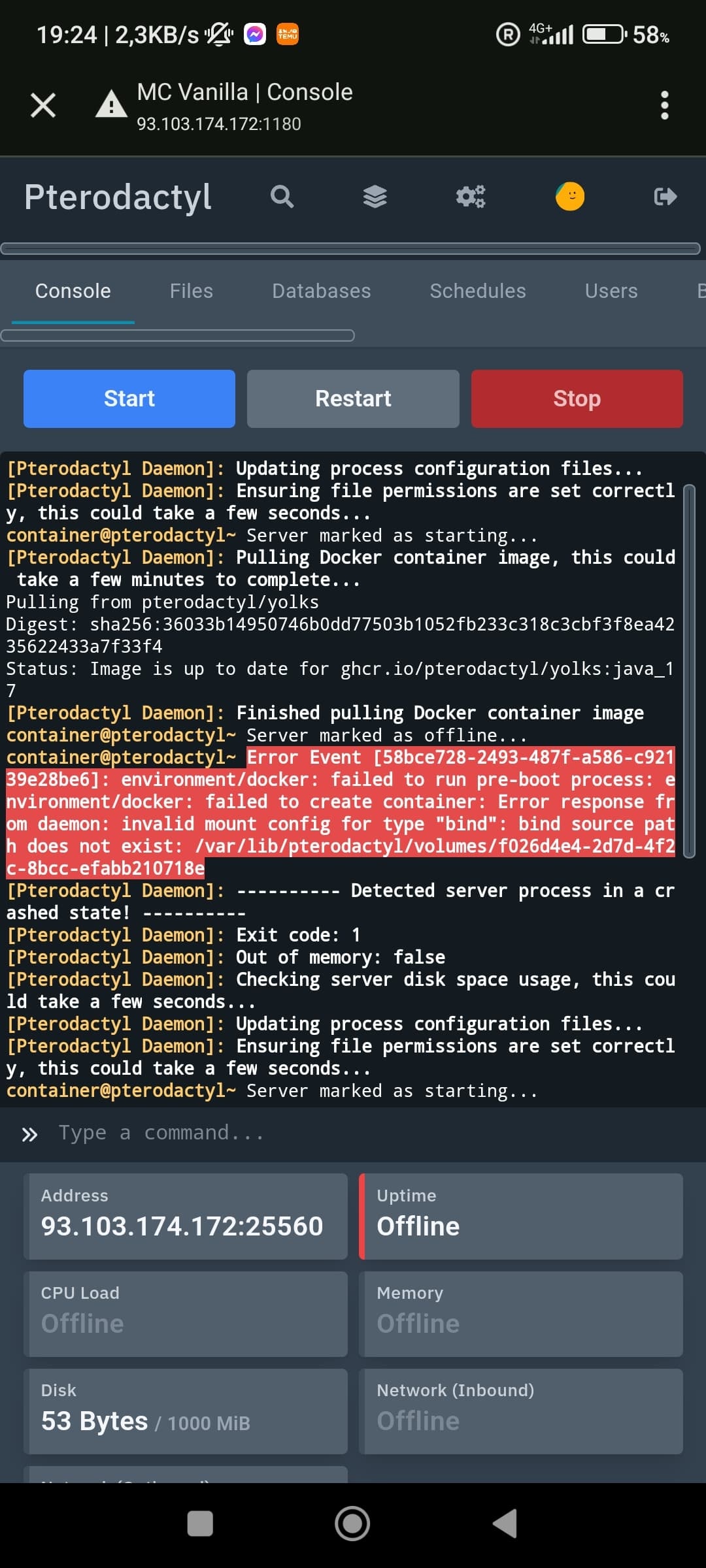

Another problem?
Dont know how to “bind” or whatever he wants from me :joy: sorry
